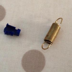

    Many thanks Blagard I replaced the head yesterday morning and the problem is fixed. Claire

    I haven't been here so not fixed yet. I thank you again for you last reply. I took the actuator off. I could move the valve to different positions easily using my hand. In the down (HW) position the heating did not come on. Taking the cover of the actuator, a spring and bit of plastic...

    Bits out of actuator

    Hi My radiators don't get hot unless the hot water is also switched on. I'm wondering if the problem is with the actuator (which this morning I knew only as a blue box in the airing cupboard). I've tried looking this up already but can't I gather that the switch positions are as follows...
