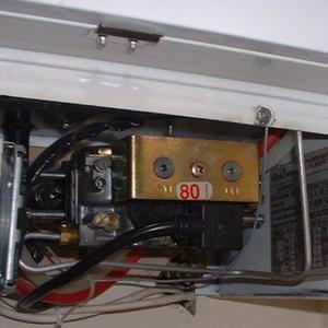

    Glowworm Ultimate - replace or not
    Hmmm.. that's interesting. Thinking about it that's probably a better description of my sound. As you say, it quietens down when it warms up, presumably as the coils expand with the heat which stops them vibrating as much. I might try and record the noise, (just for a larf:)), so you fellas...
  2. C
    Does that fit the Glowworm Ultimate 80FF?
  3. C
    Presumably the increase from 15mm to 22mm pipework is the Part P bldg regs 'bit'? Do you think the gas control valve includes the solenoid? BTW, I've just realised that the link I gave didn't display correctly. It SHOULD have been...
  4. C
    It's 960010006 I assume the 96 is the year of manufacture and that's about right because the house was built in 1996 and it was installed new at that time I believe.
  5. C
    Hi, I've got a Glowworm Ultimate 80FF which has started making a 'pulsing' whine noise. I had it serviced, (because it hadn't been serviced for a couple of years anyway), by a local company and they said it was the solenoid making the noise which, IIRC, was part of the valve assembly but I...
