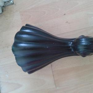

    Sottini D'amore bath feet fitting
    Just incase anyone was interested, i have fit the feet!! So, the "Real" feet are a z shaped bracket with an adjustable metal foot, this slides the top part into the metal bar on the underside of the bath and then screw into place. The leg then goes down to the bottom foot which is adjustable...

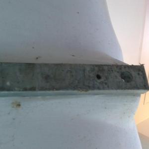

    Hi there, Pics below, http://www.diynot.com/network/colboy8/albums/11935 Hope this helps. I also saw on another post that someone had a similar set up but had screw in adjustable feet. Looking at the metal bar below the bath it could be that this has a small screw threaded hole...

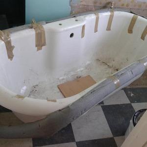

  13. Sottini D'amore Bath and feet
    Here are pics of the feet and bath that i cant just seem to get together
    Hi, I recently bought a Sottini d'amore bath from gumtree but I have no idea how to fit the feet. Does anyone know how this is done? They have a very small screw hole but i doubt this would hold any weight. The bottom of the bath has two meatl bars running across (left to right) the...
