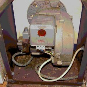

    Riello 40 not firing
    Oilman - what you suggested worked, once I got the fan moving it fired up nicely. However the following day it went out again and I still can't get it back on. Now the fan is going and the plate lifts. I can hear the oil pump going and a spark, but it shuts off about 5 seconds after. I took...
    Thanks for the advice...I'll try that once I get back to the house. It's too cold to keep my son here on the days I have him!
    Gremlin16 thanks for your reply. I had tried to bleed the boiler as I had to a few years back by opening the hex brass nut on the bottom left of this photo (this is not my boiler just extremely similar), however no air came out as before. By bleed the oil line I assume you mean...
    Hi, I ran out of oil during the night and turned off the control panel in the morning. I got oil delivered, turned the control panel on (indicator lit) went out to reset the boiler and there was no reaction. I went back in to check the control panel and the display was off. I changed the...
