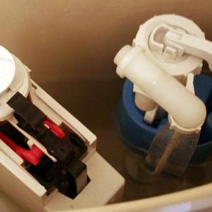

    Toilet dribbles after flushing
    Thanks for the info. "Seco Services" also suggested this as a possible way of curing the problem. My nephew managed to get the flush valve out and found that the seal was contaminated with small amounts of rubbish that looked like scale. He cleaned the outlet and the seal. So far everything is ok
    Thanks for that. My nephew who took the picture is going to have a go !!!
    Thanks for your reply and excuse my ignorance but which part of the 2 visible items is the valve?? She lives in a flat and there is only one wc and I have no idea why it is connected to a Saniflow
    My mother has problem with her new toilet installed in her flat.. It is an Ideal Standard dual flush compact cistern (15 months old) connected to a Sani Flow. After flushing it continues to dribble, wasting water and the Sani Flow then powers up on a regular basis - particularly a problem for...
