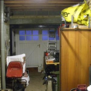

    Double layer Fireline board
    Cleared one half of the garage now and just had the back wall and some other areas in the garage repointed. Getting prepp'd to start mounting some board soon. However, despite the fact that I take on board everything that "Prentice" has said, I am still very much in 2 minds as to fit additional...

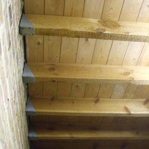

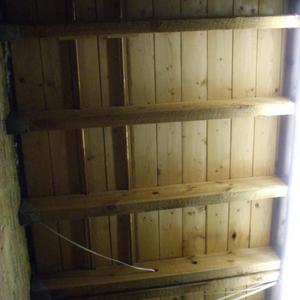

    Thanks for the very prompt reply. We had the ceiling removed when we had an extension built across the back of the garage last year. At some point, during previous works before we owned the property, the ceiling board had been cut to take CH and water supply pipework - some of which ran about...
  5. C
    Hi everyone, Been using this forum at various times in the past and found it very helpful. Only just registered today as I need some advice, so this is my first post. Hope I am posting in the correct section. We had the asbestos ceiling in our garage professionally removed a short while...
