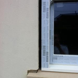

    how to reduce external block work skin for new window
    Hi sorry for the delay been tied up at work . Now thinking I may weather board past the window so I could batten out and trim around the reveal. Craig
    as you can see its a rendered finish just wondering if i can cut down some light blocks to infill then render round and to the window?

  7. C
    I'll try to get some pictures on later today thanx
    Buying a new window wouldn't do it as the window fits perfect in the inner skin bigger window wouldn't fit
    Hi after removing an old window I realised the internal opening is smaller than the external opening. But the new window fits across both skins and i'm now left with 40mm gaps around the sides and top of the new window on the outside. I'll try and get some pics up
