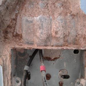

    Thanks Sparkwright - I've attached some photos, are these anygood? The first one is of a socket in the living room, the other 3 are of light sockets? Does it look like pyro/MICC?? Would it be ok to leave this as is as long as it conforms with r1+r2 / insulation resistance tests etc...

    Thanks Sparkwright - I'll check if its metal tomorrow but I'm pretty sure it is, and get some pictures. I can see conduit going upwards from the light switches, and when I changed a light fitting (class II) before in the living room, I'm pretty sure it had some sort of conduit running over...
