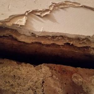

    Hello all! I have been helping my mum prep her stairwell for re-decorating. She had a large swelling on a wall that we knew was a problem and was one of the reasons for stripping everything right back. The swelling has been there since she moved in (14 yrs) and has not become any worse in...
  7. C
    Help filling a hole please!
