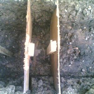

    Conservatory Foundations
    Hi All, Many thanks for your replies. I've finally got the company to see sense. What they are now going to do is dig the entire trench about 15 inches deeper. This will take the overall depth of the trench to about 1 metre. They are then going to pour the concrete about 12 inches deep...
  2. C
    Many thanks for your reply. I thought this was the case. Everything I've looked at on the internet says just what you're saying. The company has said if the build was subject to building regs they would do it the way you've stated. Howver, regs don't apply and a deeper foundation isn't...
  3. C
    Hi All, I'm having a conservatory built and the company has just dug the foundations. There is a plastic drain that runs along the back of the house and they have dug down about 2ft just exposing the top half of the drain. The company now wants to pour concrete directly onto the drain. I told...
