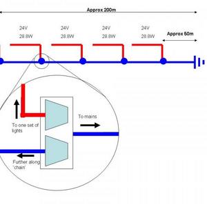

    Suitable cable size for 200m length
    Just for my own understanding, could someone please write out the calculations used to work it out as 0.6A and the voltage drop associated with that. It's apparently not the calculations used by Holmslaw but I'm interested to know how it's calculated and how you calculate that the 1.5mm arctic...
    Hi all, Thanks for all of your reponses. I'm glad the plan works. Please could you confirm whether I could use 1.5mm Arctic flex or whether I would have to buy the 2.5mm Arctic flex. The comments seem to be debating over an order of magnitude (0.6A vs 0.06A) but would the higher value...
    Hi All, A query for all of the romantics out there and any help you could give with this would be really appreciated. For a friend's wedding, we want to string up 5 sets of fairy lights, in series, which cover a total approximate distance of 200m away from the socket. i.e. The furthest...
