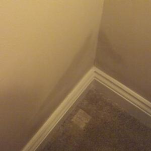

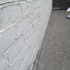

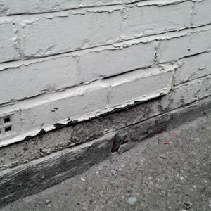

    Damp/Condensation Bottom corner of room
    Hi when it rains it lays on the path there is no guttering as it's a flat/straight gable end. The slat from the dpc isn't part of an extension no its part of the original structure but it looks like a previous owner filled in a window on that corner. There was a lean too shed on the side which I...

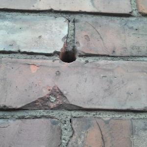

    here are some photos of the wall outside and the DPC and the area where the marks are inside. The wall has a chimney breast and the damp marks appeared in the cornrs near the chimney breast and the corners of the room (4 marks). I immediately opened windows to ventilate the room and when we...
    Hi no potential source of water either side of the wall. It is the side of my house/gable end and it is basically just an side path down the side of my house. The floor is wood. I will tape some plastic to the wall and see if any condensation forms on the plastic and which side. I have...
    One thing that puzzles me about this is that the cavity insulation was installed over a year ago now and the corner in question has shown no sign of condensation build up since and it only started once we emptied the room and painted etc. I didn't discover the holes until around...
    Thanks guys I can't remember who the installer was but it was all arranged through EDF I will pull out the 25 year gurantee certificate I have and see if there are any details about the installer on there and get them to come and inpect. I suspect that they will deny any liability and deny...
