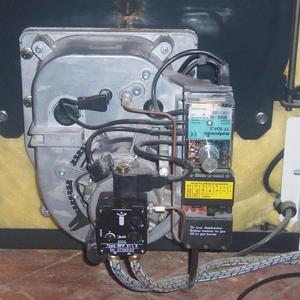

    I had another fiddle round and you're right, the red light IS the reset button, I didn't realise the middle bit pushed in so it's WORKING . :D Bless you, bless you and thanks for your patience with a novice idiot Linda

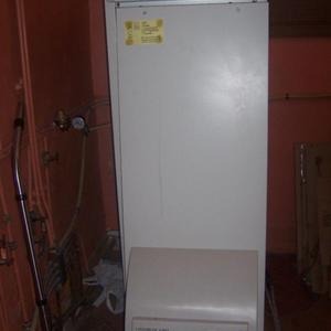

    Neither German nor Polish do it for me I'm afraid but here's me boiler, outside and in Hope this works Linda

    I've searched pretty thoroughly, I took the front off and cannot find anything vaguely resembling a reset button apart from where there's a label saying "Rechauffer fioul en fonctionnement" with an arrow pointing to the side which translates something like "reheat fuel oil operation" and I would...
