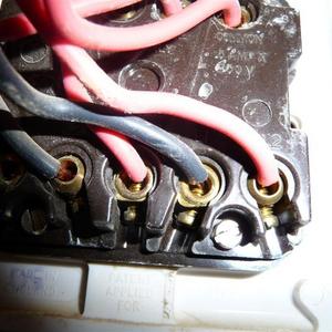

    2 way switching problems
    Hall lights, will switch on from end A and off from B - but will not switch on from B if switch A is off. First 2 pics single gang switch B 2nd 2 pics three gang switch A Switch B (Crabtree) has 2 cables servicing it - a 3 core and earth - Yellow, Blue and Red + Bare earth and a 2 core...
