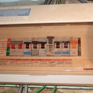

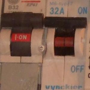

    mcb tripping upstairs ring main
    http://media.diynot.com/122000_121127_11421_34157641_thumb.jpg Image There the two we swtched round the one on the left is the problem ring. When we switched them round the same ring kept on triping so its not a problem with the mcb itself. I find it odd that this problem just suddenly...

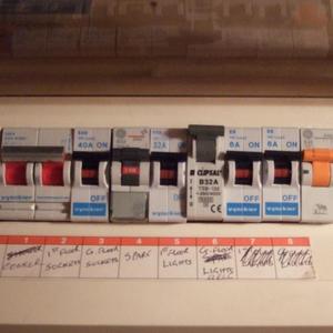

    Here are the pictures http://media.diynot.com/122000_121127_11418_68545286_thumb.jpg Image http://media.diynot.com/122000_121127_11417_31831758_thumb.jpg Image 3rd one from the left
    My upstairs ring main has been intermitently tripping now for about a week. ive unplugged everything apart from a fridge/freezer and it still trips. It can take anything from 1 hour to trip up to a whole day before it trips. So thinking it was the fridge/freezer I pat tested and it...
