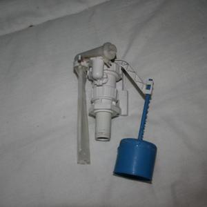

    Problem solved - found small plumbers merchants who has sealing washers for just about every valve ever made!

    Valve - flexible connection screws to bottom of thread

    Cistern is an Armitage Shanks Conceala - it's about two years old and came ready built-in to fitted bathroom furniture [now dis-continued].

    Has anyone know where I can get a replacement 1/2" microvalve for a Conceala WC cistern? I've just taken the existing one apart and found a split in the rubber diaphragm - hence the constant overflowing!
