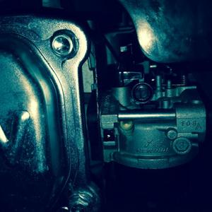

  1. D
    Petrol 3.5hp Lawnmower
    made a make shift pin all is sorted and running amazingly - thanks very much for putting up with me and all your help Davie
  2. D
    found out wat it is carb float pin missing where can i get replacement???
  3. D
    right engine running no prob now - the only thing is that the old gasket seems to be too big for the groove between the bowl and the carb - i tried to get it to fit in but it keeps on leaking out a hughe amount of fuel - should i replace that? if so where would be a good pace to get one? just in...
  4. D
    i have totally blasted the carb including the jet as this is where most of the gunk was just in the pipe leading up to it - there was a fair bit in the bowl as well so i have that steping in someon the fluid - want to make sure i get all of it or as much as i can before putting it back on
  5. D
    hi there managed to strip the mower carb this morning - what do you know? a whole lot of brownish gunge in the bottom of the bowl - no wonder its not started - just need to go pick up the carb cleaner from eaurocarparts will give it a good clean out and fingers crossed its a go .

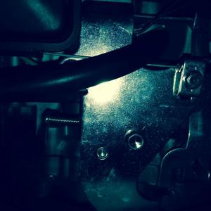

    the screw is in the third picture with the spring around it -

  13. D
    it is a Tertiary 3.5 BHP one and ill get on the photos right now

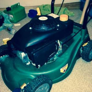

  14. D
    Hi folks i recently got a petrol lawn mower it was 2 years old . great running . done a few cuts with it - then it started to cut out - not tick over properly. So i done the usual - clean filter was and dry it 9 foam filter. clean spark plug and leave it apart to make sure it dryed out if it...
