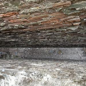

    1800s house damp
    Not a great pic, but gap when looking down on it, from our open window. It is a maximum of 50cm wide. I could just fit down it, but not sure i would be able to twist etc. I have also found that all the way along is a concrete 'channel', for water drainage, which drains into their main...

    1800s house damp
    JohnD Posted: Sat Sep 13, 2014 5:51 pm Post Subject: Are there gutters on the buildings above? What are the dimensions of this gap? I'm not there at the minute, There are gutters on ours, not 100% about theirs, but pretty confident there are. Gap is about 30-40cm wide (at a guess)

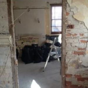

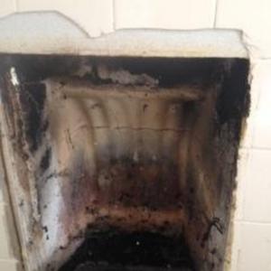

  11. D
    1800s house damp
    John. As requested - photos of the property (hope you can see?) Still very much a work in progress as you can see. these aren't of the damp. We bought it and it was looking ok, so we thought, gut it - make it messy!!! Really chuffed to find the stone fireplace - we thought it was a stud...
