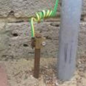

    there's a garage at the bottom of the garden...
    Guys Your advice is much appreciated. :D FLameport - I was starting to think the same about 2 core, but I'm going to play it safe and go for 3 core 16mm AND have an earthing rod at the garage. :roll: I think I'll go for MCB and RCDs and both ends. Total overkill. (The garage is all...
  7. D
    Sounds like a good idea. I assume the earth they're a big copper rod slammed in the earth? [/url]http://upload.wikimedia.org/wikipedia/commons/7/7d/HomeEarthRodAustralia1.jpg ..soudns easy enough, although I've never installed one before. Would this change the spec of hardware as...
    Thanks guys. Just two points to clarify, I've just checked again, and you're right, there is no fuse between the meter and the main CU - just the henley block. I seem to remember being told 6mm was too small, 10mm about right (but with no margin), and goldilocks favourite was 16mm. Would...
  11. D
    Hi guys, I'm new to the group, but very impressed with all your advice...and quick wit... :wink: For my first enquiry, I would appreciate your advice in regards to a hardware spec. for electrifying :shock: my garage. I'm after about 32A at the garage (6A lighting, 6A extra...
