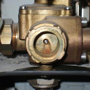

    :lol: It look's as if it was the Diaphragm after al, I got one online and fitted it two days ago, the one in the unit was almost paper thin and breaking down at the edges. It took me about an hour to shut down, drain and fit, and than drain back online. two days later and no sign of that...

    I was wondering if the 343565 Diaphragm - 3 Way Valve could have a split in it causing the leak. Many Thanks Paul

    I took a couple of pictures the other day, I hope this helps, its leaking from around the pin shown here: You can see the disclolouring. Thanks for the speedy responces. Paul

    Leak from around the pin.

    Hi, I wonder if I could ask for a little advice, my Baxi 105e Combi boiler has developed a leak, for the three-way diverter valve, could this be caused by the diaphragm? The water that is coming out is from the Central Heating system.
