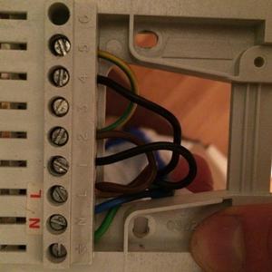

  3. D
    Denfoss randall SET2 replacement issues
    This is the current wiring. Thanks

  6. D
    Hi. Thanks for the reply. The heating and hot water controlled by a HSA 3 valve. The boiler is Potterton Prima F 30 F boiler. I start to understand more of the whole thing. If the htw on connected to com the hot water comes on. Same with the heating. So my hot water cable connected to htw on...

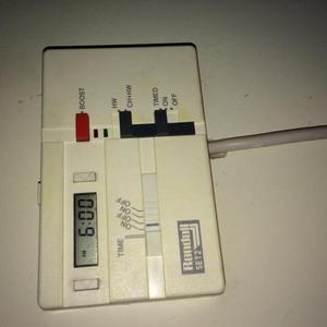

  7. D
    Hi guys. I have a randall set 2 timer switch which has gone faulty. Im not a plumber but the plumber found out that this was the fault on our heating system. So he said just need to change this timer. Im currently doing my NVQ in electrical installations so I said I can do that. For a...
