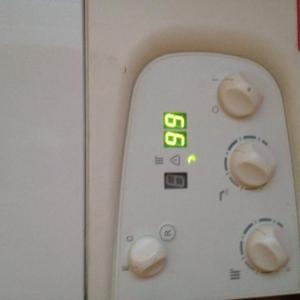

    Nah, was a thermistor. Exactly as i thought. I diagnosed, local gas guy installed. All ok

    The pressure dial shows 0.85. 0-0.5 Red 0.5 - 1.5 Blue 1.5 - 4.0 Black

    Hi, have a warm new year everyone, it seems I will be having a not so warm one. I have a Ariston Micro Genus II combi boiler in the flat. Today I noticed that there is a problem: When taking a shower, the water was hot for around first 15-20 sec, then it becomes cold and does not heat any...
