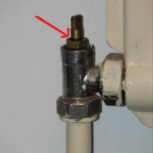

    Hi again Sorry I didnt manage to take a pic, I've been chiselling away at door frames - the life of a DIYer. Anyway, I've decided to replace the valves and I have 2 new ones, a few wrenches, a radiator key and some ptfe tape. The radiator seems to have well and truly leaked the water out and...

    Thanks for the quick replies. I'm at work right now so I can't take a pic of my actual valve, I understand it might be different inside so I'll take a picture when I get it. So even though the water is coming out of the top of the "bolty bit" (is that the packing gland?) that the "water flow...

    Hi I've read through quite a few posts on this forum about leaking valves but I'm sure my radiator is leaking from a different place. When I put the heating on and top up the system the radiators get hot but then the small one in the bathroom starts leaking. Mostly from the "adjustable" valve...
