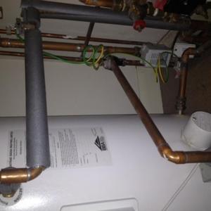

    Hot rads upstairs when heating is off!
    Here's the layout in the airing cupboard, you can see the Honeywell valve at the bottom of the tank behind the pipe, the Drayton Valve is the white one, it seems to open and close okay but the Honeywell one doesn't move. Thanks.
    There are two 2 way valves, one on the bottom of the Cylinder (Honeywell) and one labelled as central heating valve. when we turn the CH and HW off, the Central heating valve actuator moves but the Honeywell one at the bottom of the cylinder doesn't. Could it be this one, should this valve...
    No it's in the utility room, unless it's faulty I dont think its that cold in there as its attached to the kitchen. It seems the pump is constantly on today and the boiler fires up when it feels like it. The programmer is not due to have the HW or the CH on at the moment but the boilers still...
    Just noticed the boiler firing when it's not supposed to. Would this create too much hot water that then the cylinder has to get rid of, so it's pumping into the heating system? But then why would it only be upstairs??
    I will enquire with the Council on Monday, thanks. The hot water is set to the same times as the heating so swithches off at 8pm. The pump is running now and the boilers not fired up, I tried turning the Thermostat down in the hall and it's still pumping!
