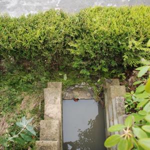

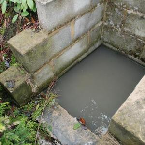

    blocked drain responsibility issues.
    http://www.diynot.com/network/downinalbion/albums/ cant seem to get pics up on this post so here is link above.
  2. D
    I own a 1930's house and have been there about 6 months. The main soil and top water drain has recently started to block.There is an inspection man hole less than a meter from our boundary,which then goes to the pavement and road. I bought some rods and had a go at clearing it.I managed to...
