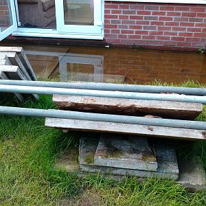

    Hi , My garden is at the lowest point , as compared to all other nearby gardens. Due to this I have water clogged patio, on top of that there are no drains installed in my back garden. United utilities paid a visit and suggested abt drains to be installed. We have got quotes from people to...

    Got all the water drained. Them some quick fix with whatever I had available in the garden shed. Tomm I m planning to get quick set cement and block the water seepage. Hopefully it will delay further flooding Many thanks guys, you all were great help! A few pics to follow...

    Hi , Good morning! It's been raining heavy today. Emptied all water yday eve, just to have new puddle next to my patio. Saw that water is infact coming in from next door garden. Any fix for this till i get gardener to sort out ACO drains? Have a look at the vid pls. I m panicking now..next...

    @JohnD -- the front of the house is almost in line with the grass, which is at the rear of the property... No garden in the front. The grass slopes towards the patio, which appears like a shallow ditch sitting between the grass and the conservatory. Hope this gives you a picture.. I am told that...

    Washing machine, dishwasher and sink are all the front of the property. I won't be able to take this water in that drain. So you both suggest I route/ channel water via ACO drain and connect it to rainwater system underground. How much you deep are those rainwater pipes you reacon? Also do I...

    Thanks for reply. I too have ACO drain on my mind. But to connect to drain, my nearest drain is in my neighbour's garden . This is shared between his n my house. I m not sure if he wud allow us to drain it in manhole which sits in his garden. ideally he shud allow ..but never know. Anyother...

    House is not on the hill. But garden slopes towards the house. And yes, grass is higher than patio. Either side is house is plain grass n pebbles. They are on higher land than my patio. Same as grass level. What is dpc? Sorry, I m fairly new to diy world. Add pics in the album, garden , Have a...

    Here are more pics. I guess I have covered all angles. I assume previous owner would have taken permissions when he built conservatory. Does that not include sorting this drainage thing out. My hope is he had permissions but did not invest in rainwater drainage.

    Thanks.. attached a pic ..
