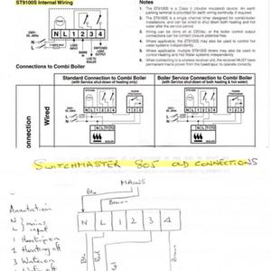

    Well I got and installed the new unit. It works perfectly, wish I had asked the question as to whether it would work before purchasing the ST9100S. A lesson has been learned! Anyway, thank you all for your assistance.

    Thank you all so much for your help. I will purchase the ST9400A, it is the most basic but does all that I need. Hopefully this one should work. Will let you know the outcome Thanks again

    D_Hailsham - yes I did buy it from ebay. Basically I wanted to get an electronic timer (the old switchmaster was noisy) which I thought it more than adequate to control the hot water twice a day, I had not considered the diverter valve which jackthom brought up. Since you can program out the...

    yes it does - what you say could explain a lot. can you suggest an alternative device that would do the job? Thanks for your reply.

    I purchased a Honeywell ST9100S. A simple single day timer ideal to replace my old Switchmaster 805 programmer that recently packed up. The Switchmaster originally controlled the heating and water but was later changed to operate the hot water only, the central heating is now controlled by a...

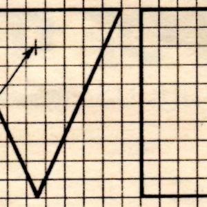

    OK D4n1el, hope I'm not breaking any copyright rules will add the pages, here are some comments about the building Have added details from article, you can print them out on A4, hope it will be readable. Will add a few notes on what I did. 1. Diagrams of each part I enlarged to A4 to...

    Hi Footprints, I am under no illusions, although only 1 he is quite boisterous and I made some modifications because of that. No I did not design it, it was in a diy magazine and I liked it so much I kept the pages; that must have been 30 years or more ago. I don’t know who designed it nor...
