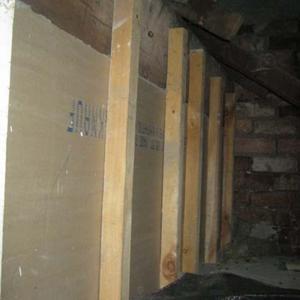

    Are these support required?
    Thanks that's what I thought, they don't look like they support anything but thought Id better check. I was planning on putting some doors on so the plasterboard will need to be cut out anyway. thanks
    HI, We've moved into a new house and want to use some of the loft space as storage. However the space between some of the batterns are a little smaller than some of the boxes so I was wondering if I could remove one? Possibly increasing the support either side? Thanks Dan
