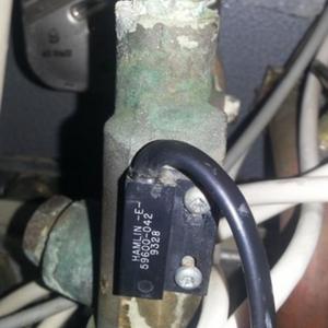

    I have just tried what you told me to do and the boiler stays off, so it must be the flow switch is jammed as you said. However on tracing the wires back to the switch this is what I have but it looks nothing like what other pictures seem to show, is this the right part and how do I...

    Thanks again for the reply, now this is where I start to fail in the knowledge stacks what is the dhw flow switch I have added a picture of my boiler is it the green connector on the pipe to the to mid left?

    Hi All first post here. We have a Worcestor 350 Boiler the one with two pumps. Recently it was cutting out when running hot water too long the button on top (lockout reset button) had to be reset to enable it again, so we had the thermostat replaced along with the Expansion vessel and the...
