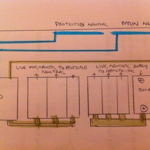

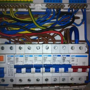

    Tripping RCD on shower, Not knocking the supply off.
    Ok, thanks for the input. I've read my onsite guide a bit more, and asked a few colleagues. this is what I think i will do. Im going to cut the busbar pretty much bang in the middle and separate the two circuits, then have the RCD feed the sockets and shower. allowing the lighting to be fed...
    nope im pretty sure it runs straight though. starting to think that its been wired up incorrectly.
    Hello. I have been called to a mates flat due to concerns about a faulty shower (despite having a limited knowledge of domestic installations) Basically whats happening is when he turns the shower on it trips the RCD in the consumer unit, but this doesn't knock the supply off to the...
