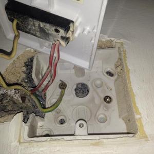

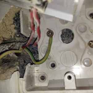

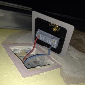

    One cable, two seperate switches...HELP!
    Ohh i get ya, so if i didn't want the switch in the same place as the other switch i could have done it that way. If i didn't already run the new cable from the existing switch up the wall, through the ceiling and plastered over it i would have contemplated doing it that way tbh.
  2. E
    Thank you for all your comments, its been really really helpful. Ahh i see, so what i have at the moment at the switches are 'switch legs'? So i got to: 1, Tap into the earth and push it through to my bedrooms switch (and ground the switch cover). 2, transfer the old switch wiring to...
  3. E
    Hi everyone, I have been on this forum for a while as a reader but i had to join as i run into a problem while trying to put a new light in my room.. I want to change my bedrooms 1 gang switch to a 2 gang switch, then run a new cable from the switch to a new light (hopefully sharing the...
