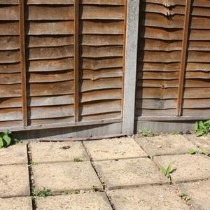

    Decking over a patio - Advice needed
    Not far oiff the way we went in the end. Me and a mate got it done in 3 days together. Step 1 removed 49 flag stones, not fun. Step 2, realised that it was not a concrete base, but can only be described as 20 year old ***** patio job. A crumbling pile of sand, broken bricks, tiles and any...
    Was kind of thinking that myself, only thing is given the cost of skip hire materials etc, it can't be far off getting a landscaping/decking company to do it..... Have been meaning to get this done since we moved in a year ago, just had a newborn though, so could do without massive projects.
    Hi guys, I need some advice on how to adress covering this patio with decking. As you can see from the images, the paving slabs are very un- even. The concrete base is cracked in places and it is both generally unuseable as it is and a bit of an eyesaw. Under the slabs appears to be hardcore...
