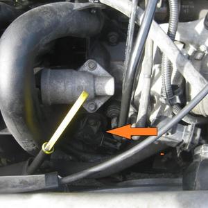

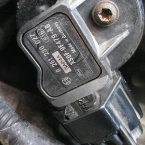

  2. F
    Mass air flow location
    I realised it wasnt the MAF sensor in the end, the car I have doesn't have a MAF sensor but instead a MAP sensor (Manifold absoloute pressure). Ive replaced this and the car is much better... Apart from now, when I depress the clutch after driving or release the drive train from the engine, the...

  6. F
    I can't see any sort of electrical connection on that side of the air duct or around the air box :? I will double check though, I think I'll go and take some pictures. Thanks for the response :)
  7. F
    Hi all, I've been having trouble with my 1999 fiesta 1.25 zetec engine running rich. I took the car into the local mechanic for a diagnostic test and it came up with two fault codes. One related to the throttle position sensor (TPS), which I have since changed, this has improved the issue by...
