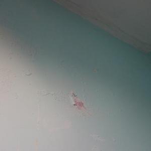

    HI thanks for the responses, now that it's better weather I've managed to take some pictures. As you can see the flashing under the window is just siliconed at the sides. The thing you can see under the Upvc cill is some material the builders stuffed in there after calling them out to do...

    Hi looking for advise on where to go with this. Not happy with the roof finish on our extension, damp on the now internal house wall has blistered paint, when it was really stormy it was like a water fall inside the house, the builders came out quick but just applied lots of silicone everywhere...
