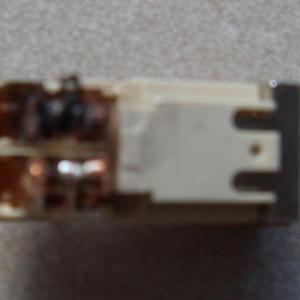

    Same problem here, thanks for your help, changed fuse & relay, hope the miele will wash again, have to try this evening. Take a look at this butifull little (burned) thing! O sorry, a 200 D Card on a W838 Miele..
