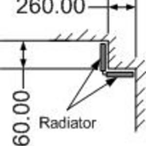

    Custom made radiators
    Can anyone point me in the diretion of someone who can either custom make or modify a radiatior. What I am after is a vertical, right angled radiator to fit around the wall that encloses the waste water pipe that runs floor to ceiling. The wall around the waste water pipe measures 260mm by 260mm.
