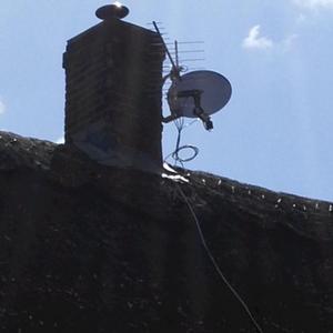

    Humming noise from chimney
    In the end I didn't I have to remove the aerial. I just got the local TV guy to reduce the length without loss of signal. No more humming. I've been sleeping without interruption ever since!
    http://media.diynot.com/202000_201948_58824_75692649_thumb.jpg This should be the culprit shouldn't it? No wonder it vibrates through the whole house. I've tried sleeping in different rooms but I hear the low hum everywhere Thanks
  4. Aerial Hummer
    Aerial Hummer
    That has to be the culprit doesn't it?

  6. F
    Thank you so much for posting this - Having suffered the same noise for two years I was considering moving - I thought it was a generator from an adjoining school but could never identify where it was coming from. I've suspected the fridge, a local fish farm, a generator, vibration from the...
