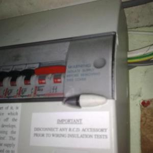

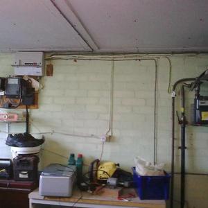

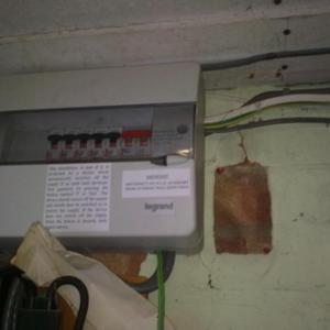

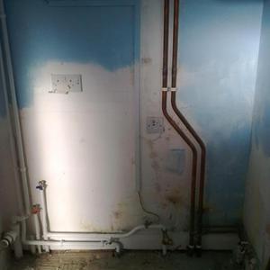

    Earthing
    Image 2 shows the earthing to the stopcock. the earth goes across the house and is then earthed into the C U (the earth cable is actually behind the white cable in Images 1, 3, &4). Image 1 shows the other earth running from the main gas supply to the CU. The other black pipe next to the gas...
  2. F
    Earthing
    Thanks. The rising main is earthed and so presumably, if there are no plastic pipes I could assume that effectively all the other copper pipes and metal appliances are earthed and that I only need worry if there are plastic pipes which put appliances beyond the earth ? but even then, I can't...
