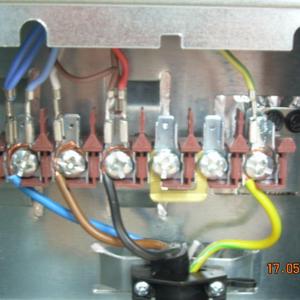

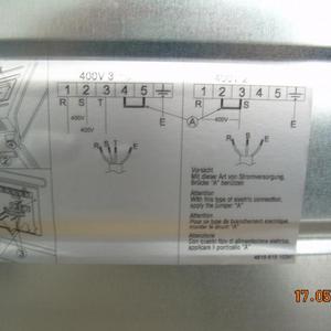

    Yes blue was a neutral. Rewired for 3 lives and no neutral and all worked well. Thanks again for the assistance. :)
  2. F
    Installing a replacement cooker in Switzerland
    Many thanks for the advice - I rewired it and now working like a dream :D

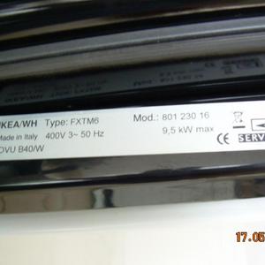

    Thanks for your response John. I've taken and uploaded 3 pictures that may help. 1 of the label, 1 of the circuit diagram and a third of the terminals. Below is the link to my album: http://www.diynot.com/network/fred100/albums/ Would be great if you or someone can help me. Thanks.
