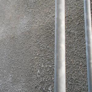

    outside wall
    outside wall- appears to be a ridge in the pebble dash render- i think this ties in with the top of the damp

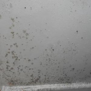

    inside wall
    Damp on inside of wall

    the conservatory is small- 5ft 6 deep and 10 ft wide. the big front wall is a small wall with windows on top- this does not have mold. The other big wall is doors into the living area. - no damp there the other small wall is just conservaory doors to the outside The fourth wall is...

    Thanks for your reply- i did try to add two pictures to my album and load them here- but it did not work- I will try again. The conservatory is on top of the downstairs apartment- . The wall i think is breeze block - with a grey pebble dash on the outside.

    We have a small conservatory on the front of our 1st floor apartment. It the winter the one wall-without windows gets very wet. The blinds get black mold and the windows are very wet every morning. I can wipe the windows, clean the blinds- but should the wall get so wet ? The wet rises about...
