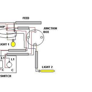

    Wiring Diagram - is this correct?
    One thing I was not aware of, and I think i've found this is meant to be correct - I was just buzzing out my connections and noticed that the neutral is earthed at the ceiling rose - taking this back it appears this is direct from the feed. Is this correct?

  3. G
    Think I found it - live broke off while connecting to rose.

  5. G
    OK, it didn't like that! As of yesterday, all cables in place but not wired, feed was the only connection all upstairs lights worked fine. Added this connection (exactly as diagram, no switches or lamps wired in yet), put the power back on, only half the lights upstairs work...
  6. G
    Hi, Yeah, should have made it clearer. The bottom of the rose is just meant to show where the lamp connects to , but these are actually connect to the terminals above - added in picture below: All correct?
  7. G
    Hi, Can someone tell me if this looks correct? Thanks.
