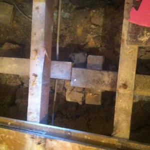

    Ground floor joists floating
    mmm no replies yet. Well just to update anyone who might be following this thread: - We decided to try sticking the concrete bricks on the bases using expanding foam. No idea whether it's the best stuff to use, but at least it was easy to apply and it seems to be setting fine. - To raise...
  2. GeddyLee666
    Hi, We recently installed laminate flooring in the living room of our ground floor Victorian house (built approx. 1900). The laminate floor was fine until a couple months ago we started noticing some bounce in one part of the floor. We removed part of the laminate flooring and lifted some...
