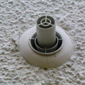

    External boiler flue - water ingress
    Hadn't thought of the gutter but it looks OK and the sealing looks OK/ I think it may just be that the very strong westerly winds have been blowing the water in. If that's the case then with the design of the outside bit - essentially two open ended pipes with no cover - it's not surprising a...
    Hi, We have a ~5 year old Viesmann condensing boiler on the wall in our kitchen. The flue goes straight through the wall to the outside, facing west. In the recent severe gales and rain we've had, small amounts of water have found their way back into the boiler cupboard on a few occasions, and I...
