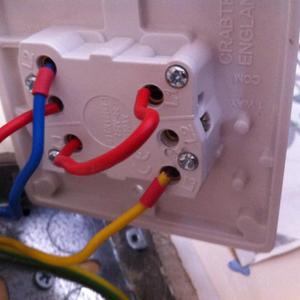

    Wiring a 2 gang one way switch
    Perfect! Thank you Andy. It was upside down so moved the yellow and bingo.....thank you very much.
    Does this help at all? Thanks. http://www.diynot.com/network/Geoffreyr/albums/
    Hi All, I've had a look through the forum without much luck... I am attempting to replace a broken one way 2 gang switch that caters for two lights in my dining room. I have purchased like for like I believe with the switch having l1, l2, l3 twice each as before. There are red, blue and yellow...
