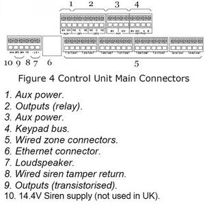

    Is there is any chance you can guide me through the new image (http://www.diynot.com/network/georgetheod/albums/22363/83876) I've added with my panel wiring connections? Thanks for all your help and sorry for this but I haven't done it again before and I don't want to mess something up ;-) I've...

    I think I have sorted out how to connect them after your last comment EightyTwo and thanks for that! Basically I have 3 programmable Input /Output terminals (T1-T2-T3) on my BGSM-120 dialler and I will do the following : I will setup (through my alarm keypad) the output O/P4 of I-0N40 to be...

    I found the comms harness but I really don't understand how I should do the wiring. Below I uploaded the comms and gsm dialler instructions pictures. Is there any case I get any help on this? ;-) ps Many thanks to sparkymarka and EightyTwo for helping me out!! In case the images are not...
