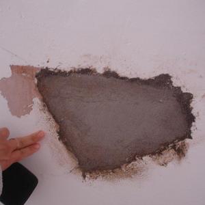

    Efflorescence
    We've just done a bit of digging and found a couple of photos taken in Oct 2009, just after we moved in. They show the affected area had for some reason been infilled with cement (!). I think our decorator just skimmed over the surface. Does this illuminate the situation?

    Efflorescence
    hi there, wouder if someone can help. i've got a nasty-looking patch of efflorescence on the wall of my c.1910 terraced house and I'm trying to work out what has caused it. The wall in question is a loadbearing solid (ie not cavity) brick wall between the living room (suspended timber...
