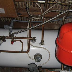

    Many thanks for the quick reply picasso....You are right, it's a RDM Utrasteel which, as you said, requires an external EV.
  2. G

    Many thanks for the info on G3 unvented qualified and for the observations on the system. That said, the system has been working fine. It's just the EV that appears to have become corroded after 2 years..which is somewhat surprising for me.... BTW I take all the credit for plonking the...

    Yep a CORGI registered plumber installed it originally. And a different CORGI registered plumber has been doing the annual servicing...Anyway, I will take the issue off-line with the plumber. Regards Glocho

    OK. I will get the plumber to sort it out. Many thanks for all the help. All posts have been timely and very useful :)

    Many thanks - Hmmm..I am wondering why the plumber installed this type of EV 2 years ago... And why this has not been spotted during the annual service checks by my current plumber... Is the replacement of the leaking EV required urgently for safety reasons Or can it wait a few days? Also...

    Many thanks for the quick replies - here's a bigger photo. Apologies for some reason it's rotated 90 degrees when uploaded to the forum.... and another: Hope this helps...

    It's connected to the hot water tank

    I have just found a water leak from a small hole in the external steel casing of my Zilmet EV. Please see the attached image: The EV has been placed horizontally on the ground between the hot water tank and the (edit: System) boiler for approx. 2 years. I have no idea how the EV steel...
