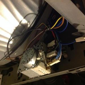

    Hotpoint Dryer TCAM80 CGZUK Wiring
    All working now, thanks very much guys. Blue / Grey to Start switch. Dark Blue to Top of Timer (going to motor)
    This was working, the belt broke, this is why I dismantled it, the wires got put back in the wrong place because of my not noting where the wires went.The problem now is that I can't figure out which wires go to the start switch. I have a Black and brown going to the heat switch as they are of...
    Lower Black wire goes to Grey wire, this is a double connector with two Grey wires. One Grey goes to motor, The other one goes to the left hand side of the dryer looking from front. Upper black wire from motor goes to unused terminal at top of timer in photo.
    Sorry don't understand. The problem is 2 wires are missing for the start switch, I suspect it was put on the timer by mistake. The Red wire at bottom of Timer goes to the motor.
    Images attached. If you need any more info let me know Heat SW - BK / BN Water Empty light BK / BK goes to rear of dryer behind motor Deep Blue wire goes to Mains input. Wires on Timer from Top W/P/BK BL BL GY/GY W / BK...
    Yes, the thing is I did not remove the wires but one came off during movement of the front panel. I need to figure out which ones go to the start switch. Serves me right for not taking a photo before doing any work.
    Need wiring for Timer as wire came off and don't know where to put back.
