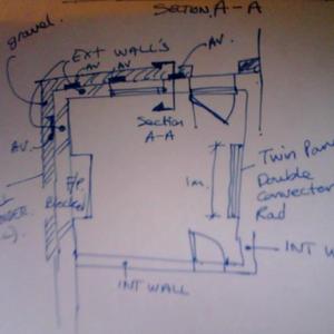

    oops typical cad engineer - The room is small, 3.5 x 3.2. Hi Seco ,I'm surprised you didn't pick up that the sketches were not done in cad. Hi Freddy, what do you mean "no measurable insulation surrounding the room"? like the walls being just solid brick and no cavity insulation? My...

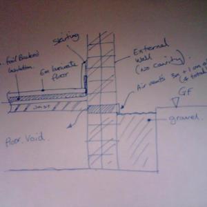

    Hi All I Have this really cold room with floorboards in my house Tipically the one i spend most my time in. On top of the floor boards it has 6mm insulation and 6mm laminate flooring. it has a 1 metre long twin panel twin convecter radiator. I can't for the life of me work out how to...

    Sketches od cold room
    sketches
