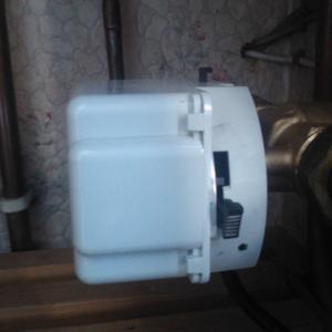

  3. H
    No hot water after new valve installed
    Ok..The only position it will go in is that one and the position it was to begin with which Ive just put it back in (the radiators then switched back on) When I try and push it further upwards it just comes back again into that position. Am I missing something here?
  4. H
    Now the switch is in this position. The boiler fired up and pipes coming out of the valve are still hot but theres still no hot water, and now no heating.

  7. H
    Ok, Ive pushed the lever and it sort of moved itself into a different position so just waiting to see if that gives me hot water for now. I'm affraid I dont have and cant use a multimeter. This is the first time I've even tried to go near anything heating related!

  13. Drayton valve
    Drayton valve
  14. H
    Hi guys, I'm new here and not sure if Im posting this in the right place. I've just moved into a new house and the heating didn't work so got a heating engineer in to have a look. He installed a Drayton 3-port motorised valve and left. The heating works perfectly but not we have no hot...
